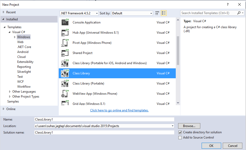

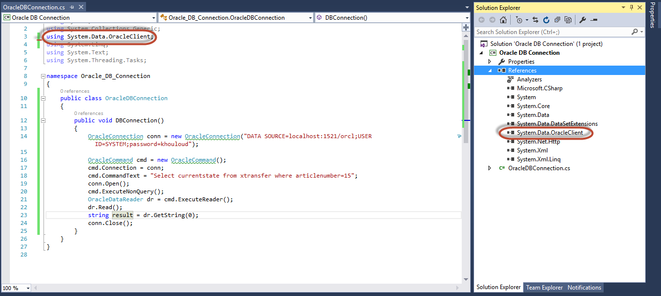

    Create one method in your class library as shown in below screen shot
    Compile your project. OracleDBConnection dll will create.

    It is possible in Aras to connect with Oracle database without creating DLL also.
    1. Register System.Data.OracleClient dll in aras. (I already mention how to register dll in Aras)
    2. Create server side method in Aras and write your connection code.
