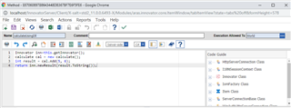

Create your method in Aras and call your dll method from aras method.

thanks Suhas . it's a useful hint.:)
sorry Suhas i get this error
