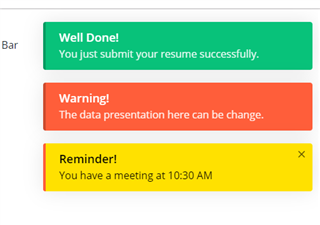

  • Maybe combine it with these self-named "Beautiful Growl Notifications" Slight smile
    https://www.cssscript.com/demo/beautiful-growl-notification/
