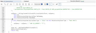

    I quickly tested and If you still want to change this functionality, I assume you are using Innovator 12 version. Follow below steps
    Step 1: Search and open PE_ReverseItemsFed_OnGet Method
    Step 2: Go to line number 102 and add below if condition (highlighted text is the only change we need to include in this method).
    GROUP BY item.CONFIG_ID
    ) groupeditem ON groupeditem.CONFIG_ID = item.CONFIG_ID AND groupeditem.GENERATION = item.GENERATION",
    startItemId, QuoteName(relationshipTableName), QuoteName(sourceTableName));
    if (sourceTableName == "PART" && relationshipTableName == "PART_AML")
    sql = sql + " AND IS_CURRENT = '1'";
    Step 3: Save and unlock method
    Try and let me know if it works for you.
