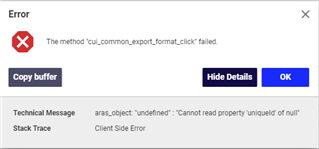

In a relationship if I'm doing export to excel, it is working fine.
But if I Clicked on any column to change sorting and tried to export to excel then system is throwing below error:

Hi Suhas,
I wasn't able to reproduce this in a local 12.0 SP6 instance I have installed. Could you confirm which version of Aras Innovator you're using as well as which relationships grid you're testing this on?

Hello Chris,
This issue is reproducing in Aras12SP1 version.

Hi Suhas,
I tested this in a local 12.0 SP1 instance as well and wasn't able to reproduce the issue. Could you let me know what relationships grid you're seeing this in? Is this a standard relationship like Part BOM ?
