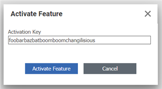

One part of setup is adding a stack of keys that all have: Feature Name and Activation Key (and unused expiration date).

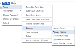

From the v12 install guide you can do this, one at a time:
As a developer/QA/exterminator in this environment that I need to replicate this is a real pain doing this 12 times before moving on. And, while I'm needing to do this on v11 and the navigation to the Activate Feature is different, I'm guessing it writes to the same bucket?
