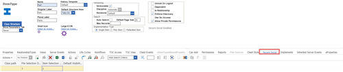

If you enable secure social for an item type, can you turn it back off later?
While there's no explicit "Disable" button, you can turn off the secure social features by deleting the related item in the Secure Social relationship tab of the ItemType.
You can also disable SSVC on a form-by-form basis by navigating to the Views relationship tab of the ItemType and configuring the Secure Social flag on the related forms.
