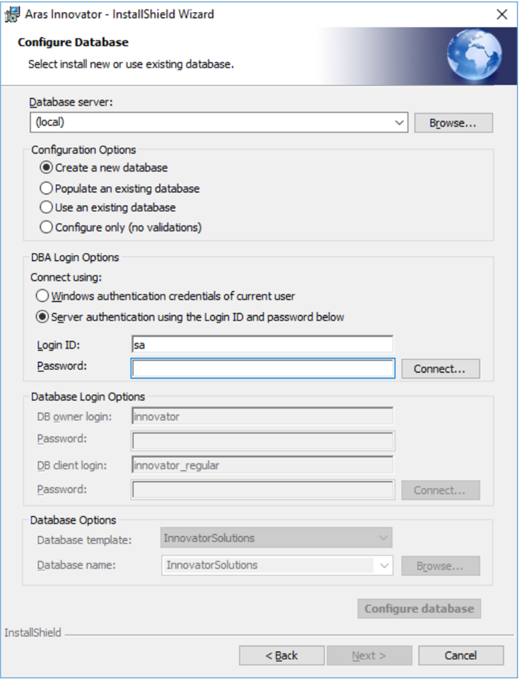

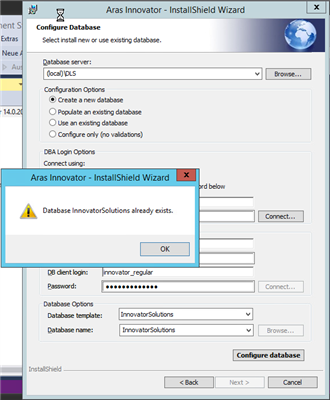

However I cannot complete the installation progress with the settings, that were put in when "Configure Database" appears.
Here is what I have to choose:
- Database Server: I am using a created Database Server called "DLS"
So it looks like: Database Server: (local)\DLS
When selecting "Create a new database" at Configuration Options, I have to choose
"Server authentication using the Login ID and password below" afterwards.
When selecting Login ID I put in: sa
When selecting Password I put in: Password2018!
as selected when creating the login and password. After selecting "Connect..." the next
options to choose are Database Login Options. Here I choose the following Logins:
DB owner login: innovator
Password: Password2018!
DB client login: innovator
as created in SQL Express
After selecting Configure Database a window pops up: Database InnovatorSolutions already exists.
So then I tried using the option "Populate an exisiting database" in the configuration options. I chose connect for the databse login options and then configure database.
Like in the tutorial video the window says: The Innovator database will be installed and configured now. Would you loke to proceed?
After choosing "Yes" the following window pops up: It is required that populated database should have user with name "innovator_regular". This user must be associated with any login in SQL Server.

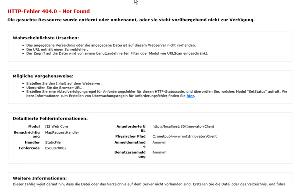

Now when trying opening the link localhost... which is also mentioned in the tutorial video the browser shows the following:
HTTP Error 404.0 - Not Found
Can you help me now? What can I do to successfully test the IE / Mozilla browser?

  • Hi Sebastian,
    I have a few questions/suggestions.
    1. Which version of Aras Innovator are you trying to install?
    2. Was the InnovatorSolutions database created within your SQL server instance?
    3. When creating a new database your input for "DB Client" should be innovator_regular. By default, all regular database requests from Aras Innovator are executed on behalf of the innovator_regular database user. Assigning this value to the innovator role will cause issues, as all innovator SQL requests would have owner permissions.
    I would recommend attempting a clean install. To create a new database you'll need to erase your old InnovatorSolutions, or create a completely new DB with a different name. Once install is complete you'll navigate to localhost/<your web alias> and you should be able to access the Innovator server.
    AJ

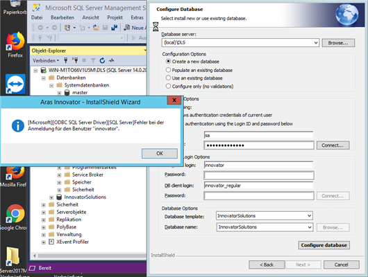

  • Former Member
    Former Member in reply to AJ Sebastian
    This window appears (It's german sorry) I hope you can understand a bit of it. It says: Access denied. I have tried it with the password which was set for the user sa.
    It says: SQL Server doesnt exist. Access denied.
    It's german language.
    The user was set to: sa
    and the password was: Password2018!
    as set in the settings.
  • It looks like you'll want to set the database server to (local)\DLS or whatever your existing server is. Sorry for not mentioning that.
  • Former Member

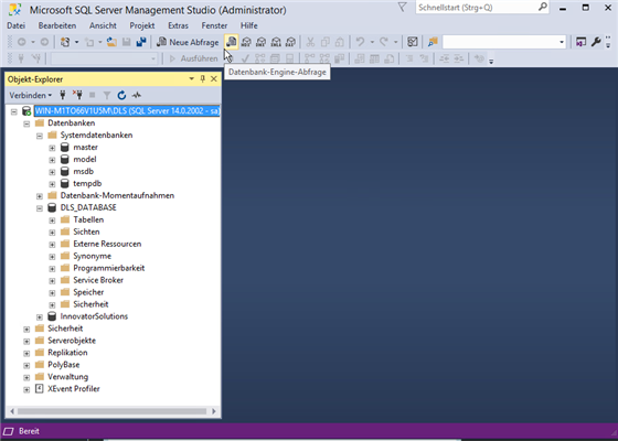

    1.As you can see my current database is named DLS
    I don't know how to erase this one and to create a new one. Can you help me there?
    Still the Aras Innovator setup says Database InnovatorSolutions already exists when trying to configure Database.
    When leaving the Password fields empty this error message appears.
    I know it might be caused by the DLS database now. But I already tried searching in google how to erase the current database... So I need help here...

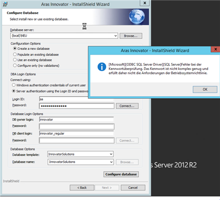

    Okay now I managed to reinstall the whole SQL Express Installation. Now I named the new database "NEU". When clicking on Configure database, the following window appears:
  • Former Member
    Former Member in reply to Former Member
    Now I deactivated the complexity of the password policy. And I got it to work.

    I can't read german, so apologies in advance. You'll want to ensure you add passwords for both the innovator and innovator_regular users.
    You won't be able to add a new innovator solutions db to either sql environment. To add a new database you'll have to delete the existing innovatorsolutions DB, which you can accomplish by opening SSMS and right clicking your InnovatorSolutions DB and selecting delete. You could also create a database with a new name within the install process.

    What url are you using to access your instance from the browser? The error you're getting happens when you're attempting to access a URL which is not associated with Innovator.

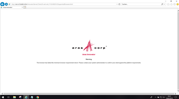

    Just one more problem occured when trying a client connected to the virtual server. Changed all settings as mentioned in the tutorial (guides...). When attempting to connect to the Server the following error occurs:
  • Hi Sebastian,

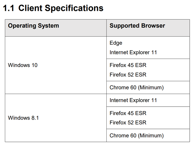

    There are some browser requirements for Innovator 11.0. The table below shows supported versions of different popular browsers which you can use to access your innovator server. This was pulled directly from this document.
    AJ
  • Former Member
    Thanks for the info. For the client I am using Windows 10 with Internet Explorer 11 and the error occurs there, as you can see in the screenshot above...
