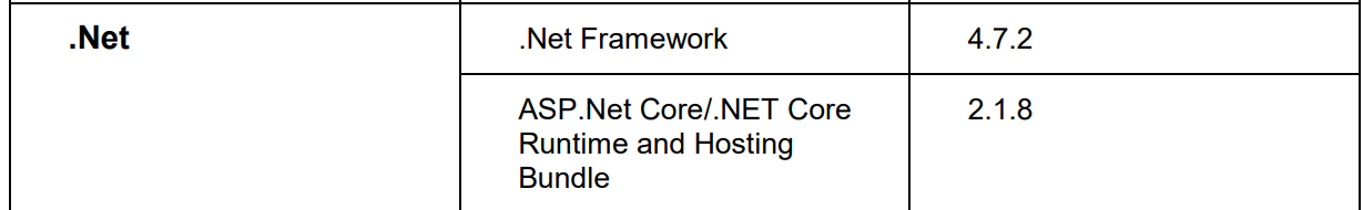

HI CC,
Can you verify that the version of .NET Core installed on the machine matches the version which is a prerequisite within the installation documentation?

I did not read properly the prerequisite (sorry), performed install of the good components.
But it's still not working, i now get en error:
"Error: Cannot access OAuth Server due to 502 (Bad Gateway)"

Same error, but only trying to install v12 in testing env. .Net Framework, Core, Runtime, Hosting versions, all confirmed - yet, still 502 Bad Gateway. Any thoughts?
Thank you,
