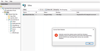

After successfully installing Aras Innovator and MSSQL, I am unable to start website "http://localhost/InnovatorServer". I am getting below error.
I have checked my IIS status and tried to start the Default Web Site. Got below error!

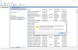

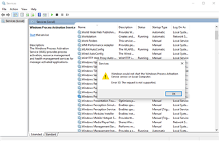

When I tried to restart Windows Activation Services and World Wide Web Publishing Services. I get below error.

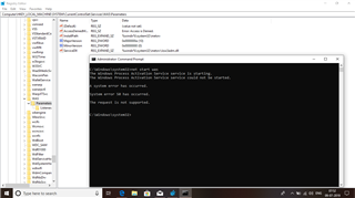

I have tried the workaround and I still see the same error. Below image for your reference.
In RegEdit, I don't see "NanoSetup" variable as mentioned in the solution sec. of stackoverflow.
