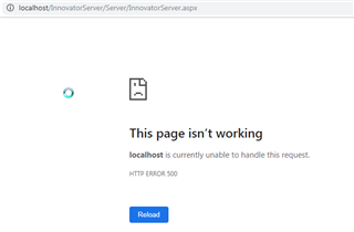

I have installed innovator 11 on windows 7.
Mircosoft SQL SERVER - 14.
Configured IIS from Built-in component of Windows 7 - IIS version is 7.5( as per Microsoft document )
IIS is correctly configured. I have created helloworld asp page and placed in in wwwroot just to be sure IIS runs smoothly and the asp page does run.
.However when accessed localhost/.../InnovatorServer.aspx IIS throws the Error -
This page isn’t working
localhost is currently unable to handle this request.
HTTP ERROR 500
Any help is highly appreciated. Thank you

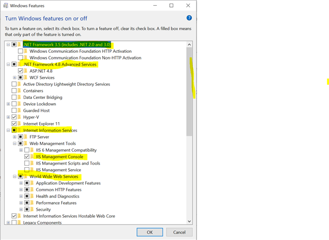

  • Hi Gautam
    1. Ensure that MSSQLServer and World Wide Web Publishing Service services are running.
    2. If yes, check IIS is running.
    3. Also check http://localhost/ and verify it is landing to IIS page
    4. Check .NET Framework 3.5 and 4.8, Internet Information Services is enabled in Turn Windows Features On or Off
    Thank You
    Gopikrishnan
  • オフライン in reply to Gopikrishnan
    Hello Gopikrishnan,
    Thank you for your inputs.
    I checked with all the points you mentioned and everything is in place.

  • オフライン in reply to gautamk
    Hi there,
    I think we should not use the URL directly. Instead when I use "http://localhost/InnovatorServer" it pops up the login page.
  • Hello,
    I just want to chime in and confirm that you should not navigate to /Server/InnovatorServer.aspx directly. Instead, you should login with just the WebAlias that was set up during the installation of Aras Innovator as you have pointed out in your comment. This will redirect you to the appropriate login page.
    Christopher Gillis
    Aras Labs Software Engineer
  • Hello Christopher,
    Right. Thank you for your comments.
    Gautam Kulkarni
