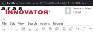

  • NOTE: My dual install dev system is looking good now... both reachable.
