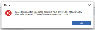

I try to upload a file to my Default vault and the following error message appears:

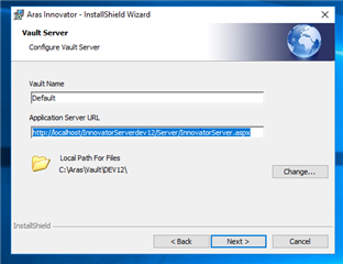

The vault has been set up as follow:

    It would appear that your vault URL is incorrect. Vault URLs are normally http://{server}/{instancename}/vault/vaultserver.aspx. Here is an example of one of my local instances.
    It also seems like "arasdev" is a shortcut you've specified in your hostfile. I've run into issues using aliases when setting up a vault, so maybe try using the actual web address as opposed to "arasdev".

    Thank you for your answer !
    It seems to work Slight smile
