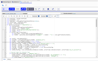

The cui_reinit_calc_tearoff_states doesn't exist. Can you send it to me ?
The only method that exists, with almost the same name, is the following :
And the toolbar is weird :
Thank you. best regards
