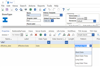

You can configure the time in the Item Type.
Long Date: Tuesday, January 14, 2019
Short Date: 1/14/2019
Short Date Time: 1/14/2019 9:30:43 PM (Allows User to Select Time)
Long Date Time: Tuesday, January 14, 2019 9:31:41 PM (Allows User to Select Time)
