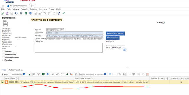

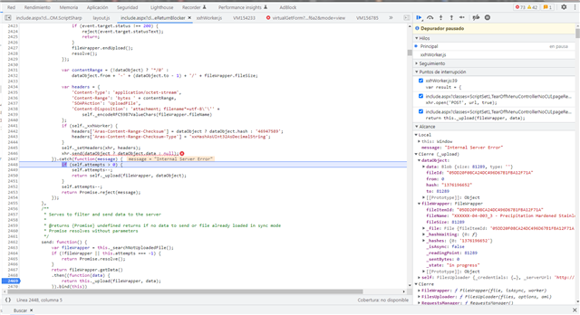

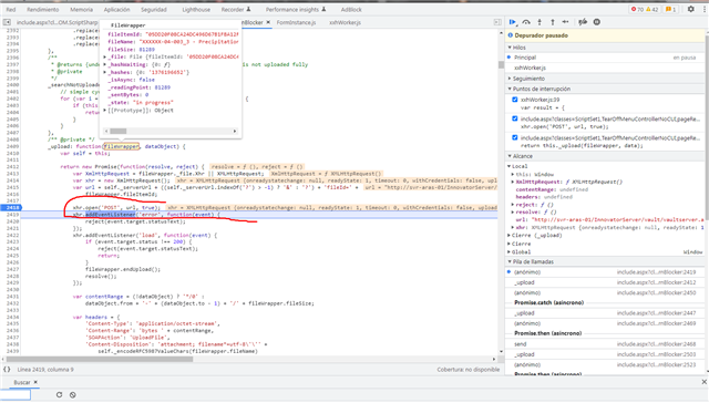

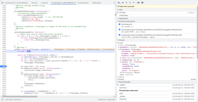

    Look, curiosity!!, I'm giving you a series of screenshots of the debugger, in case you see something "strange", you who have an expert eye on ARAS, :)
    ARAS has given the id, the full file name is in the variable, but when trying to upload it to the server, it fails. Enter an infinite loop.

  • There is nothing strange in your screenshots. As you have highlightend in the images, there is an error when sending a POST request. So probably the server disliked something.
    When uploading the file, the server either doesn´t accept it at all, or will cut the name to a certain length.

    I have seen in your screenshots, that certain characters in the file name are escaped. But not all of them. This could also be a source of trouble. But I assume in your case, it´s really just the file length.
