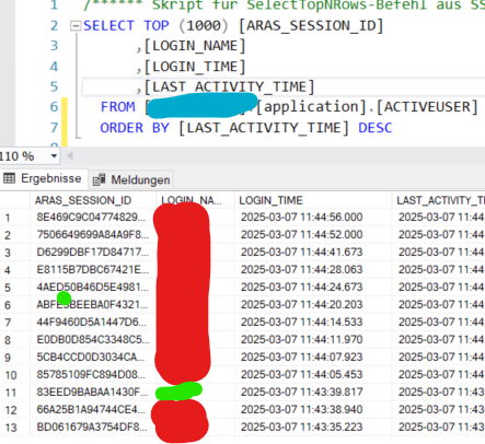

I noticed that one of my users appears with many sessions in the [application].[ACTIVEUSER] table in the database. The same user also complains that Innovator is very slow in certain scenarios. For example changing the "Make/Buy" drop-down in the Part Form can last up to 5 seconds. Opening a custom Impact Matrix with a few hundred Affected Items can take several minutes (typical would be 3-5 seconds).
I am right now confused why this specific user appears with an excess amount of sessions in the list. Typically people are only listed with a few sessions. I wonder if the amount of listed sessions and the users´ performance problems are somehow related?

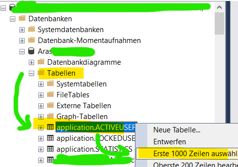

The table looks like this:
Red is always the same user. Green is somebody else.
I did some tests with the user. One new connection is created when he starts Innovator. Regular searching does not create any new session. But a new session appear as soon as he opens a Parts and clicks the "Edit" button!
For each "Edit" click a new session was created! But only for this specific user. If I do administration stuff in Innovator (editing ItemTypes, Method, etc.) no additional sessions are created. I hardly appear in the session list at all.
