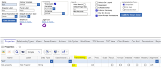

You can track history of any custom properties by enabling the track history in item type properties tab.

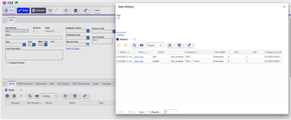

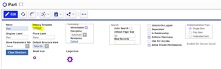

I added a property in Part item type and enabled track history. Added the property to form. When I create part and update test property, history is tracked. History template is added in Item type : Default
Thanks Gopikrishnan. I did all the right configurations but was expecting new column for Custom properties on History page but didn't realize changes are tracked under 'Comments' column. It is working for me. Thanks again for the help.
