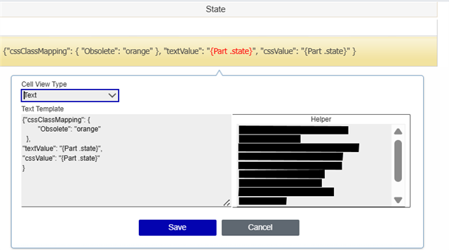

Hello Chirag ,
By using customization you can add background color to specific cell based on state condition.
It is possible in TGV to color the state cell to those part which has released state.
In a TGV editor you can apply your custom CSS. Please refer below screenshot.
As well as you may need to add same css class in "tgvViewer.css" and "tgvViewer.min.css" file.

Hi Suhas ,
many thanks for this answer! I was looking for such a solution since years!
I did an quick test in Innovator 12, but only got the plain text from the "Text Template" in my TGV. The variables for Part.state still worked, but the rest was displayed like regular text.
Which Innovator version did you use for this solution? Is this something official Aras introduced in any of the new releases?

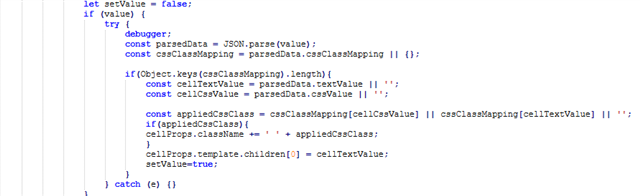

Yes Eli Donahue , We have to modified code files for same.
In templates.tsx we need to do below changes
code addition: line 218-line 234
In tgvViewer.min.css file we need to do below changes:
I hope it will work.
Please let me know in case of anything.

Thanks for the hint! I didn´t find the "cellProps" variable in Release 2023.
But it´s available in Release 26. It should also work in Release 35. There are few changes in the file, but they shouldn´t affect your code.
