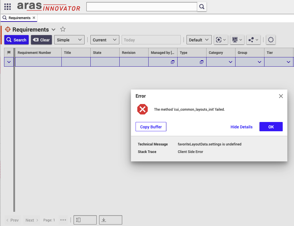

We have an installation of Aras Innovator 2024 (Build 14.0.25.40942) that was working for a while, but last week, it started to throw error messages whenever we open any table view (e.g. the Requirement table), or we use any user interface feature related to this view, e.g., change pagination size, select a requirement, etc.
In each case, the error message relates to the favoriteLayoutData settings being not found. More specifically, the following message was emitted:
> The method 'cui_common_layouts_init' failed. favoriteLayoutData.settings is undefined Client Side ErrorError message

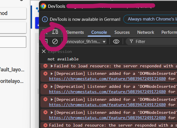

  • Which identity / user do you use for your tests?
    Is there really nothing in the browser console?
    In this debugging view, erase all existing notifications so you have a clean view to start with. Then leave the window open and open your search grid. Maybe you get something:
  • 0 オフライン in reply to AngelaIp
    Sorry for the slow response here, I did not receive a notifiation of this comment. I looked at the console as you have mentioned, and I did not seem anything that seems relevant to me, but I am pasting the results in (with anonimizing the server ip address from the logs):

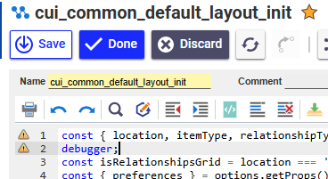

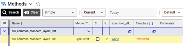

    I'm facing that issue too. One thing to check: some methods (in Aras32 at least) have Templates, and they are missing for me; it seems that this is what causes the issue:

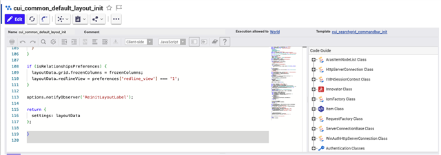

    BUT: I used my connections to ask them if there are any hotfixes on the FTP. And there are!
    Hotfix-064888.25.zip for Release 31 fixes "cui_common_default_layout_init"
    Description:
    I-064888
    The Error dialog is displayed in the Search Tab after updating the ItemType with saved preferences
    Can somebody check?
  •   How many lines does the "cui_common_default_layout_init" has in your instance? Around 98? The patched version has ~133.
    Release 2024 is based on Release 31. In this case patch might help with your problem.
